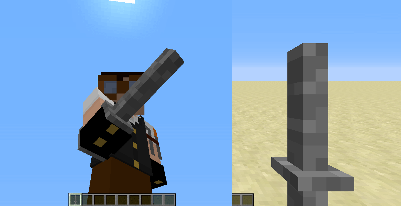

This isn't true.
1.9+
1.9+
1.8
1.8
This is a model that I changed from 1.9 to 1.8, as you can see display settings actually changed.
The reason that Cubik Studio can't export to 1.8 is because the way that display values affect items has changed, both of these have the same display values, yet they display very differently.
It's not enough just to change "thirdperson_righthand" to "thirdperson", you would need to actually edit the display values themselves for models to display the same in 1.8 and 1.9+.
