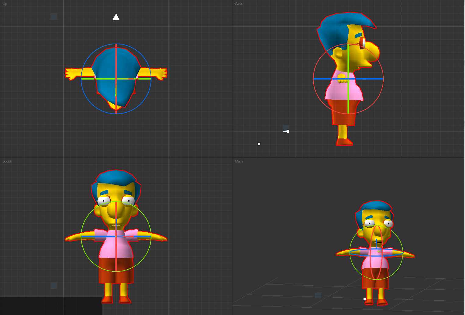

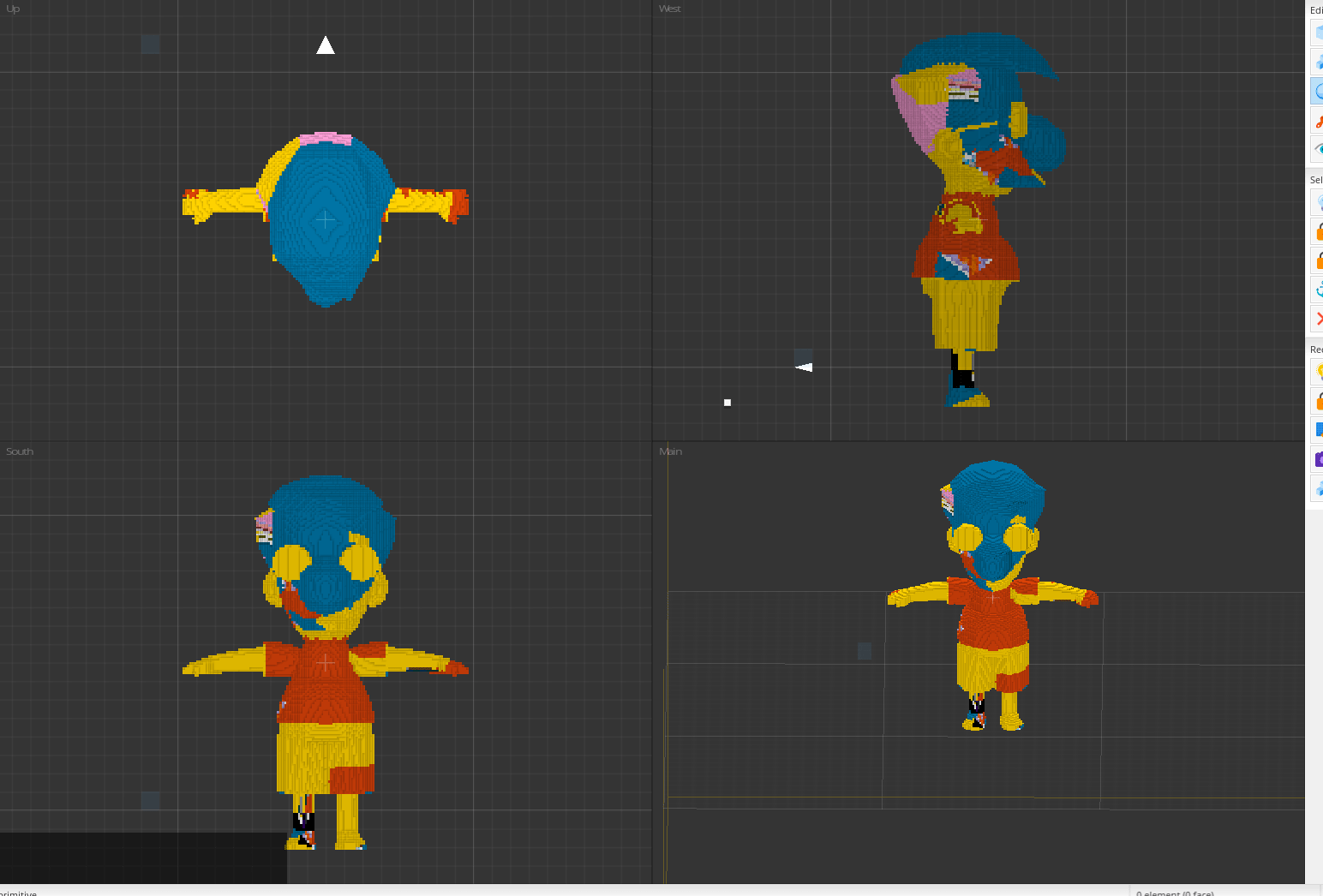

I'm having a problem when i convert some obj files to voxels the textures get messed up like this
here are the files i used
PC Computer - The Simpsons Hit & Run - Milhouse.zip
(32.42 KiB) Downloaded 432 times
and also here is a link to the site i got the model from https://www.models-resource.com/pc_comp ... del/12500/

Your issue is probably due to your model containing only one mesh using multiple textures. Cubik does not support that (yet).
Try to edit your model and assign 1 texture per mesh.

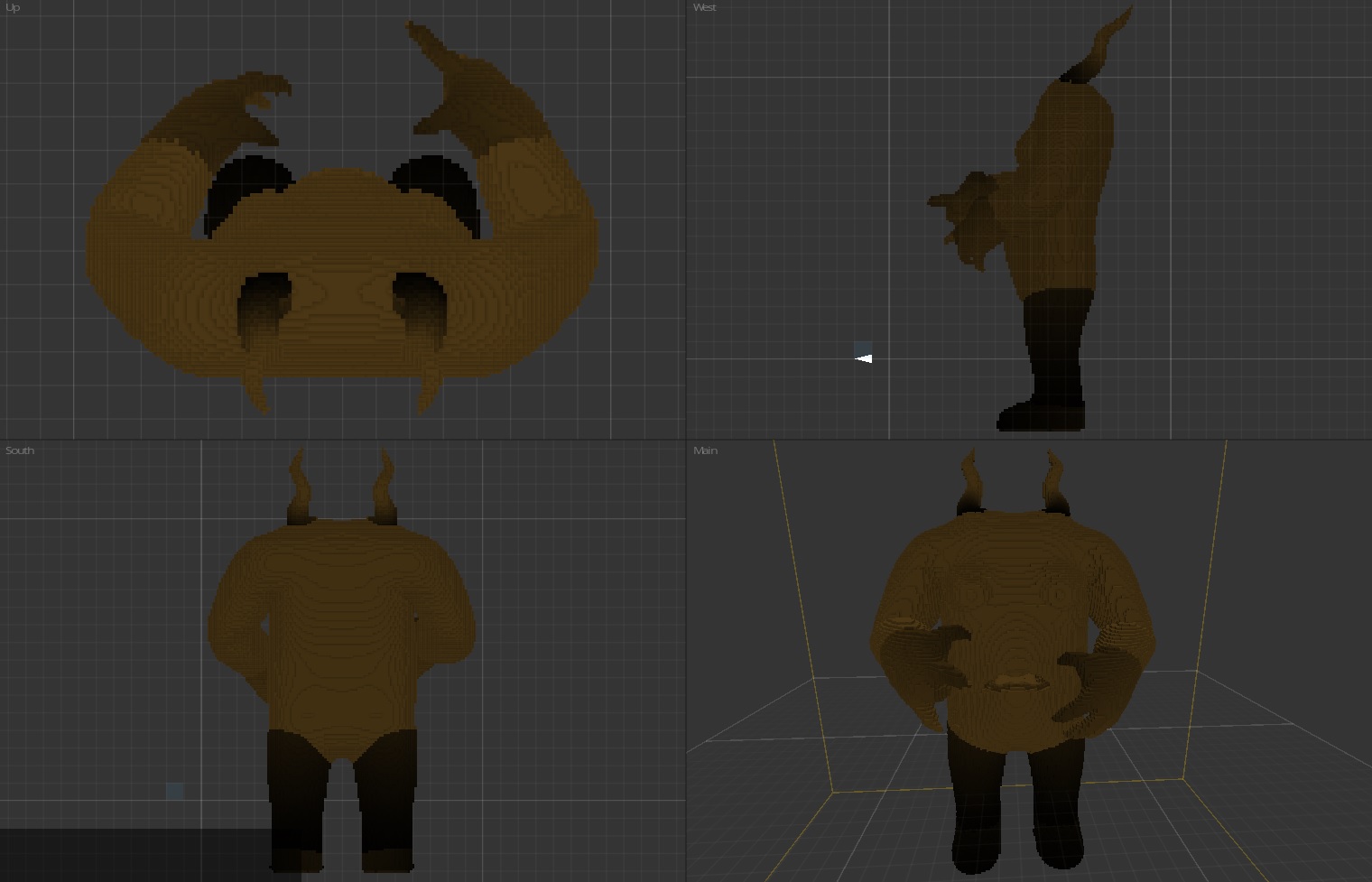

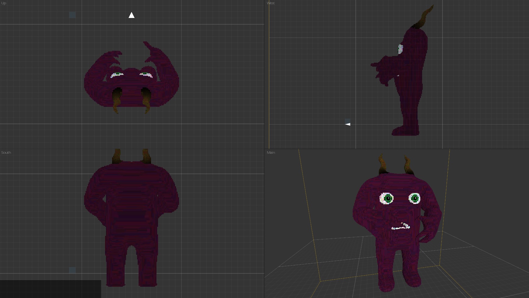

I seem to be having the same issue. not sure what's going on lol
imported mesh
after voxel conversion
here is a zip with the files to check, thanks in advance.
boxling.zip
(160.86 KiB) Downloaded 414 times

Re: texture problem when converting OBJ to voxels
Post by AndrealVox » 04 Nov 2016, 09:15
Problem Solved.
AndrealVox
Posts: 10
Joined: 02 Nov 2016, 00:53

He modified his model to use only one texture per mesh. A model can have multiple meshes and a mesh can have multiple textures. Cubik supports multiple meshes per model but supports only one texture per mesh (for the moment)

Yes, I separated my model into multiple meshes with a texture for each. This for example was split into 4 parts: Eyes, Horns, Teeth & Skin. Which was then easy to apply 4 different textures to the parts. It was a bit of a process but it's what must be done for now sadly.
