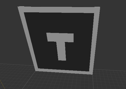

cubik studio uses a T as a indicator no texture is apply'd when painting a element the back color will chance however the T will remain has has to be painted on its own to get rid of im not sure if this is a bug put using the fill bucked should fill the enire elemt with that color and not the backcolor of the element

The "T" texture is the default texture of Cubik (and "P" for particle texture)
It's a texture and behaves like that. So if you use any paint tool on it, it will behave as any other texture.

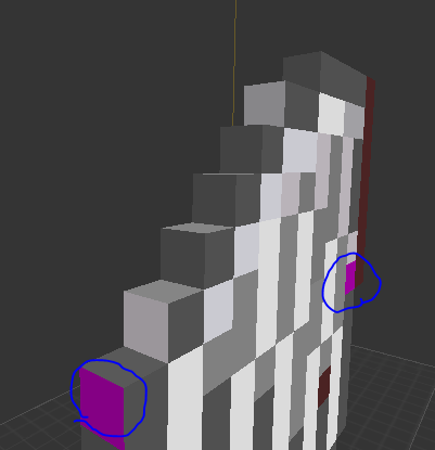

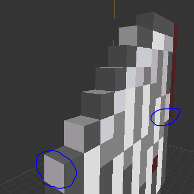

Post by weshuiz13 » 24 Jan 2017, 18:47
my problem lays in the way cubik uses the pen tool when i paint element1 his front texture red for example cubik paints element3 his front texture aswell :o
so a unque texture will not help much
take a look at 2 screenshots 1 is before the painting is applyd the second is after the paint is applyd
only 1 side of 1 element is painted purple why is the second element pinated purple as well?
this is the point tat keeps bugging me

Post by Sphax » 25 Jan 2017, 09:31
As I said, if you use the Elements Material feature to create an Atlas (keep textures), you'll get a unique texture for each face of each element, allowing you then to paint easily without the duplicating effect.
