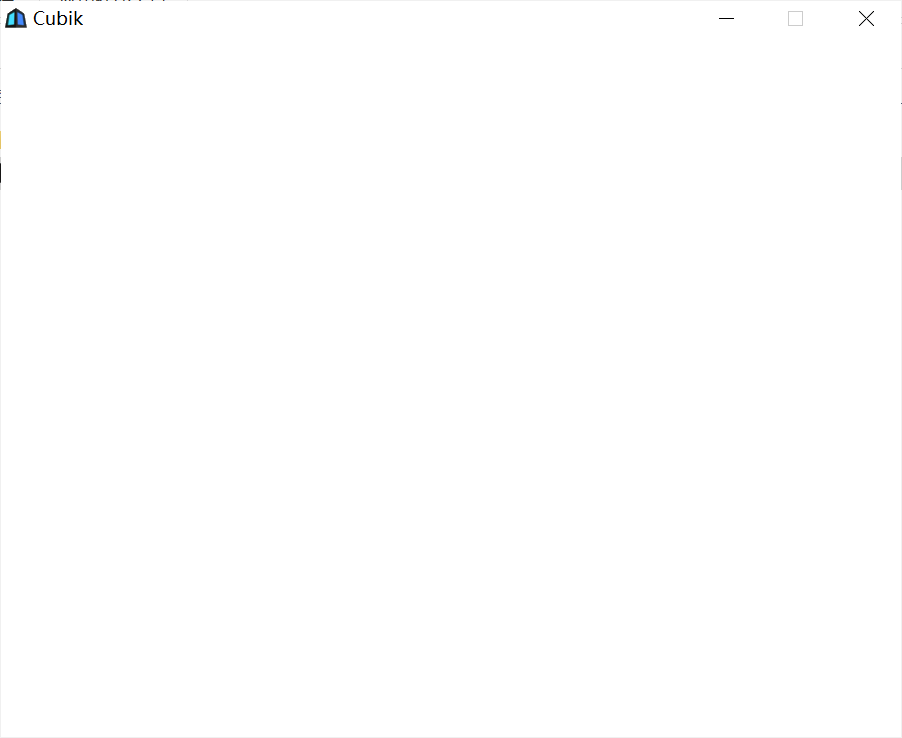

when i double clicked "CubikUpdater.exe", it pop up a window with "cubik" in the upper left corner, but nothing else,
then disappeared immediately

Make sure your Visual C++ is up-to-date: https://support.microsoft.com/en-gb/hel ... -downloads
If that doesn't fix it you can try each of these to see if it helps:
- Whilst the program is open select it in the taskbar then press Windows key + an arrow key
- Whilst the program is open select it in the taskbar and press Alt+Space and select "Maximize" from the menu that should appear in the top left of your screen
- Go to C:\Users\<user>\AppData\LocalLow\BDcraft\Cubik and edit cubikdata.json so that "windowX" and "windowY" are 0
Re: I can't install cubik studio
Thank you, after updating my Visual C++, I restarted my system, it worked
