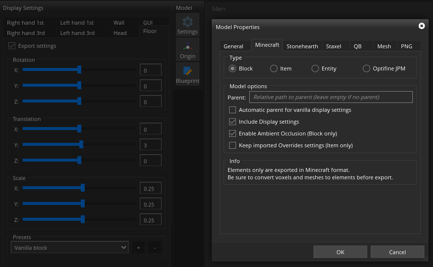

My preview values arent exporting to json as expected. I'm having to redo them either by hand or in BlockBench
Edit: Ok, so I finally figured it out. In the project settings dialog, go to the minecraft tab and enable "Include Display Settings" then save the settings. After that, inside of each preview tab there is another checkbox "Export settings" which needs to be manually checked on each and every display preview you want included into your exported json file.
Why this is so tedious and unintuitive is beyond me. I've read countless forum posts here and across Google about people not being able to export their preview values to json, with no solutions on any of them. This was the only one that said solved, but with no explanation.
Suggestion to Sphax: Preview values should automatically save to exported json if they have been changed from their default value of "0"
Image showing the checkboxes:
