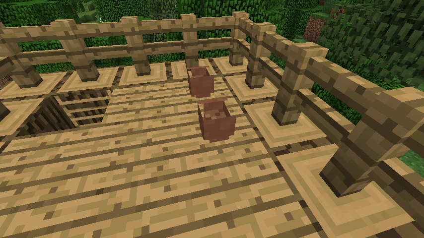

I've made some textures of e.g. a flower pot or a ladder and the textures of sides are just transparent. I don't know how to fix that. Can you tell me which setting i must have set?

I texture on side are transparent it's either the UV mapping is wrong or the face(s) are hidden. In both case edit the element properties

Select element > Go in Element edit-mode > Click element faces button > Check that all faces are enabled > Go in element UV mapping > Check if UV of each face is ok (in a non transparent texture zone)

Heres the easy fix. FIRST. If your texture has transparent pixels in it, which it looks like it would, you must make sure that the element with the invisible face is on a place with color in the UV editor. If it has color but is still invisible like this continue to this next step. In Cubik select the element that has the invisible faces then, in the panel on the right that has the list of elements right click the one you selected, go to "Faces" then "enable" then enable the face that is invisible. in this picture it appears that the "top" faces are invisible. Hope this helps!
