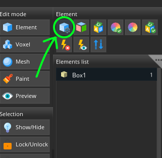

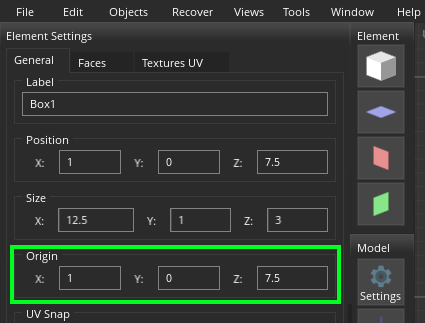

Before rotating elements you can move the origin of the element, which is the point the element will rotate around.
Click the element settings button, on the right side of Cubik.
element settings.png (18.23 KiB) Viewed 2666 times
With the element, you want the origin to change for selected, you will have to manually edit the origin values.
