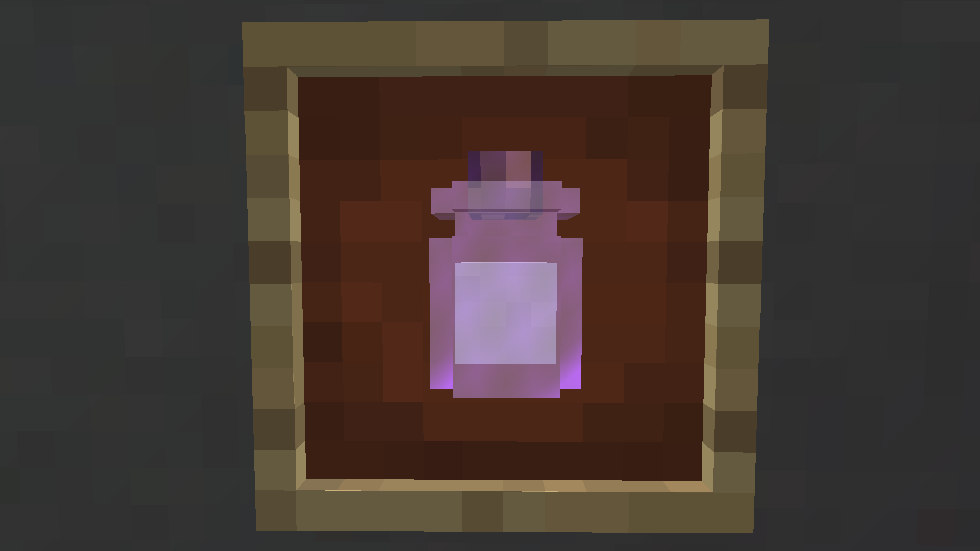

Alright, so i have another issue i cannot figure out. I have created a potion model and created a liquid element. I created a potion overlay texture so the game would change the texture from grey to whatever the color of the potion. So i added the texture that i created to the liquid element and set the paths and everything for items/. I go into game and this is what i get instead of a colored element. If your wondering the potion that is displayed is a strength potion.
As always please help!

Be sure to set the element to tint with the right index. In element properties, faces, set 0 or 1 to tint channel for all faces to tint with potion color.
