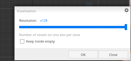

Ok so I would import any model into cubic, obj > voxel then doing the vox > elements, it pops up saying to make my model smaller than 32x. If the obj > voxel is 128x how do I expand the rate of the conversion?

try this
1. go to mash and click import mash
then go to the option convert to voxel
then go to voxel and convert to element wait to it to be convrted 100%
and go to the voxel selection modefy it if you like and the convert it to elent like you you did with mash>voxel
i would recomand the 1+ elemetn per color (palet) this should solve yyour probelm

Why are you trying only the first method to convert voxels to elements?
There are 3 methods to convert voxels to elements, te first one is very specific and the only one limited to x32 (to avoid generating way too many - and unusable - elements)
