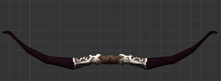

Not sure what i am doing wrong here. I read on the forum here that this happened when you had more than 1 texture for each mesh. I only have 1 texture, so that can't be the problem. Im very confused O_o
Before voxelization

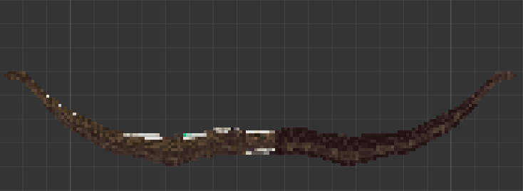

After voxelization

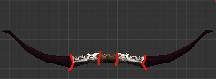

Your bow looks like to use 5 parts, try dividing each part in your 3D modeler and reimport in CubikStudio

Sphax wrote: 20 Nov 2016, 06:25 Your bow looks like to use 5 parts, try dividing each part in your 3D modeler and reimport in CubikStudio
Not sure if i understand what you mean?

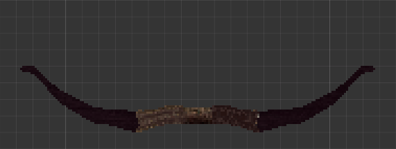

Edit: I tried dividing the model into 5 parts like you said.
After voxelization
Definitly not good enough though.
