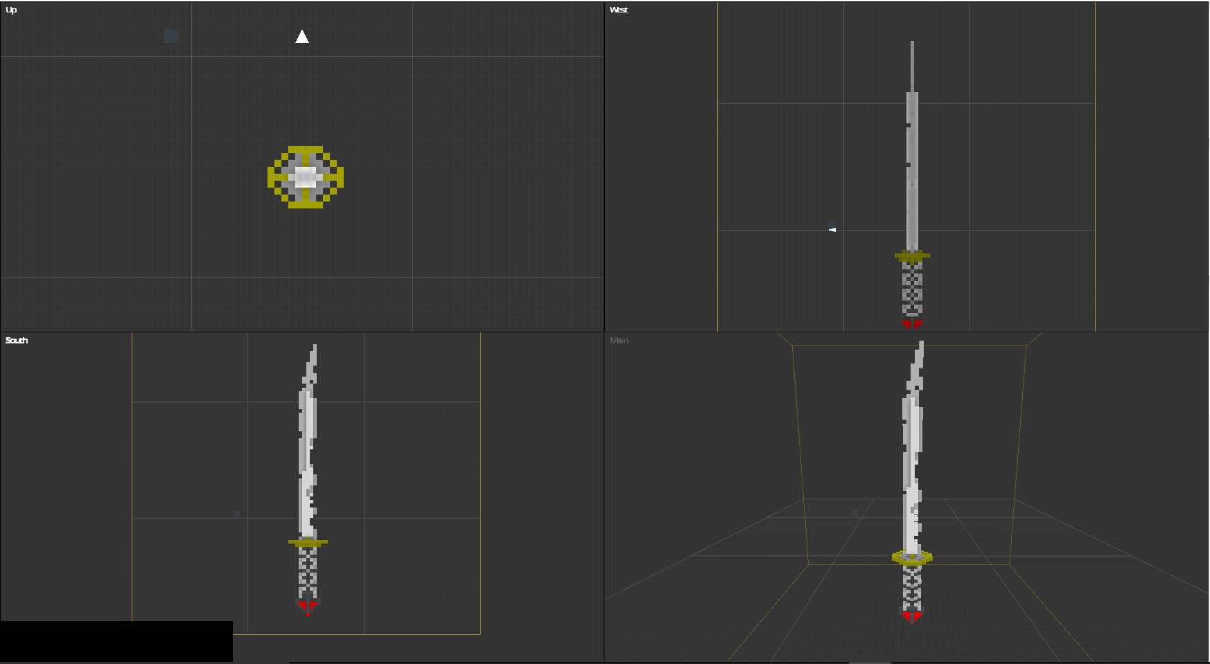

Re: How to Apply/Use Textures...?
Maybe post a screenshot of your model in voxels and a screenshot of the model after conversion to elements?

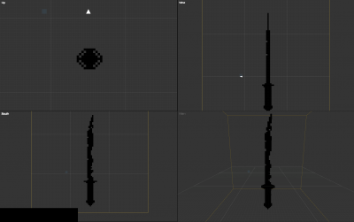

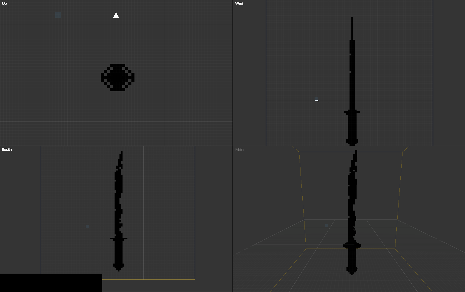

Alrighty. So the colored is when it's in "voxel mode". The blacked out is when I convert it to elements.Sphax wrote: 03 Nov 2016, 07:42 Maybe post a screenshot of your model in voxels and a screenshot of the model after conversion to elements?

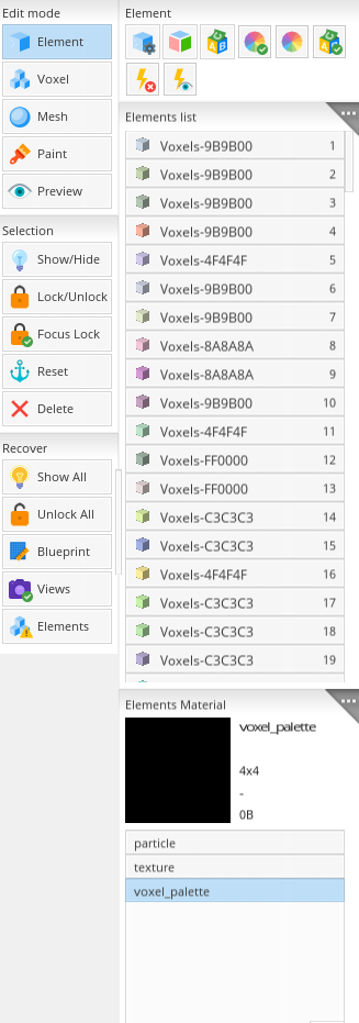

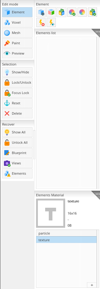

Here's the material manager before converting voxels to elements, and after. The after has the "voxel_palette". Reading that, I'm guessing there's a way to save the palette and then somehow that becomes its texture? Also, would it be possible to record like a 10 minute video just running through the basics and such? It'd be very helpful
Click the ... on the element material window. It will be listed there. Atlas is pretty much just a texture map
